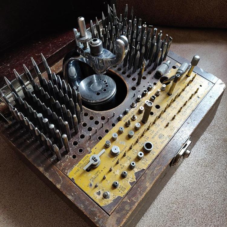

I'm looking to buy my first staking set and the above came up on a local eBay like site in Sweden (tradera.se). The seller (like me) knows nothing about the tool so the description simply says: "See the pictures". What would be a reasonable maximum price approximately? Thanks for any input on this! Oh, the brand name is BOLEY if it adds anything!?
This will be a fine staking set
For your information...
Boley is a German supplier of watch stuff and jewelry and the stacking sets they sell are from Star.
I don,t know the first thing about staking sets, yet would call this offer unbeatable.
I have the exact same staking set, just a bit newer. Landed it for 150 Canadian 5d8e1c9f8aaff5ae6095667823445e87.jpg
Isn,t KD the best? And Inverto popular.  :geek:
1 minute ago, Nutiborskoku said:
K&D are decent staking sets. I think my asking price is fair. @jdrichard simply had a hell of a deal.
The condition it is in matters, price eh. A few bucks more or less don,t matter.
Well, since the OP mentions the price in his first post, it does seem to matter in this case :)
