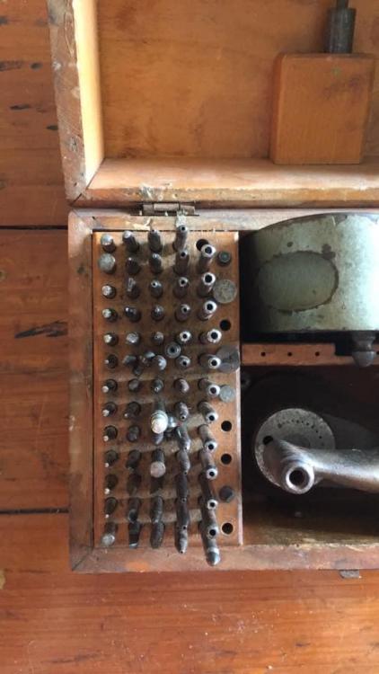

Hi That is one great set. It is a combination of the seitz jeweling tool and the  staking too so has multiple uses. professional tool. And a couple of K&D balance staff removers , One sees these on the bay for £50 to 70.
     Whats to think about. at that price go for it.
3 minutes ago, Nucejoe said:
I guess the moderators would let good members get by this time, yet thought I should inform you,
Well,  surely moderators will consider that you are new:geek:, I think mentioning a price goes against forums policies period.
It is already posted only a moderator can take it down.   Don,t worry.
K&D are decent staking sets. I think my asking price is fair. [mention=1704]jdrichard[/mention] simply had a hell of a deal.
I did:) 1/3 of the price.
I just got this one at a junk store for $60. Dirt and rust were free.  It will be a few years before I'm going to be good enough to use it. Maybe by then I'll have it cleaned up.
Junk store had a smaller set with parts missing but he said I could get it for $20.  I think I'll go back and get it for spare parts.

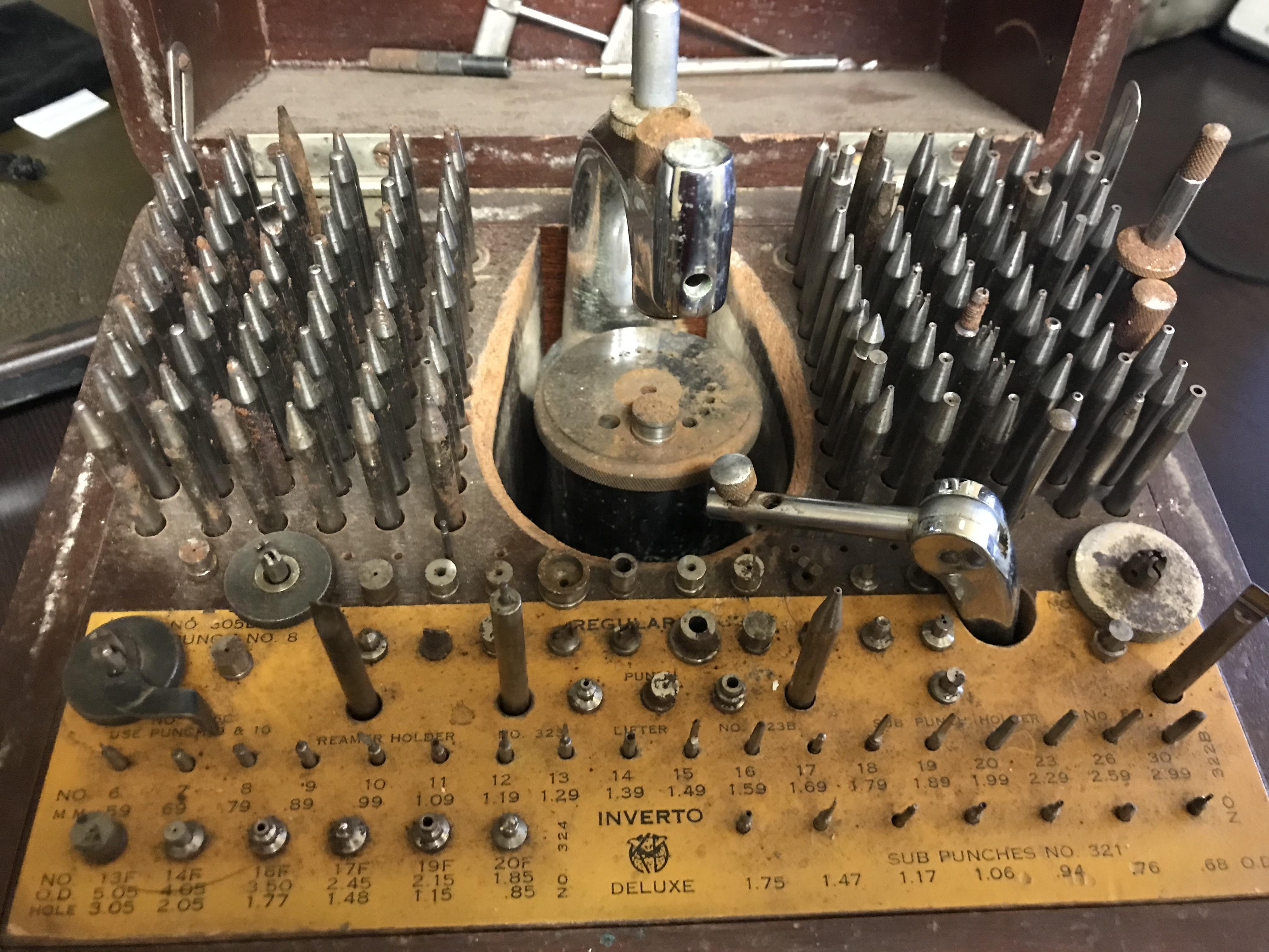

Newbie here and jumping on this thread for some advice. My local thrift shop has this vintage used Boley staking set. Do you think it's worth £95? Any advice is appreciated. Cheers.
Hi All,
Newbie here and I posted this question on someone else's thread in this forum and am not sure if I could do that so I've started a new discussion. Admins please delete if I did something wrong here.
My local thrift shop has this vintage used Boley staking set. Photos below. Do you think it's worth £95 / USD$120? Any advice is appreciated. Cheers.
Mo
There looks to be many missing stakes and plugs. New stakes/plugs can be bought from good suppliers. Have a good look at what you might buy, Do the stakes line up with the holes in the bass, make sure there not blocked, the same goes for the stakes. Looks like it all needs a good clean, this can be done and it should then look fine. You can also find second hand stakes on ebay. The price is fair. Just make sure it all works and moves free.
Thanks for the advice. I will check it out.
There are better examples available at a more competitive price, also condition is paramount.  That looks like it could do with a bit of TLC......
A fair price  regarding the condition and the fact its a Boley set.  Try and look through the grime and imagine it cleaned up. As Old Hippy mentioned spare punches and stakes can be purchased .
Hi OH, I can think of trying each stake with a right size staff to see if things line up with the holes in the base. How else can we check for alignments.
Thanks in advance.
Make sure this part (red arrow) isn’t damaged and can lock and be freed. Some types cannot be moved so check for damage. You need to have the most pointed stake and see it it lines up center to the holes (black arrow) make sure none of the holes are damaged and not blocked. The black arrow part must be able to be un-locked and locked. All punches should be able to fit into the stand with ease. Keeping the stakes in good order and the plugs will also help in the work you will undertake when using this type of tool. It is quite easy to clean the stakes/plugs with very emery cloth or the sticks, if you have a lathe it’s even better. Don’t forget this type of tool is used a lot for watch work such as b/staffs, jeweling and riveting just to name a few. Yes if you do not have a jeweling tool but you have the right punches with a stacking tool you can use it for that. The main thing is make sure things line up.
