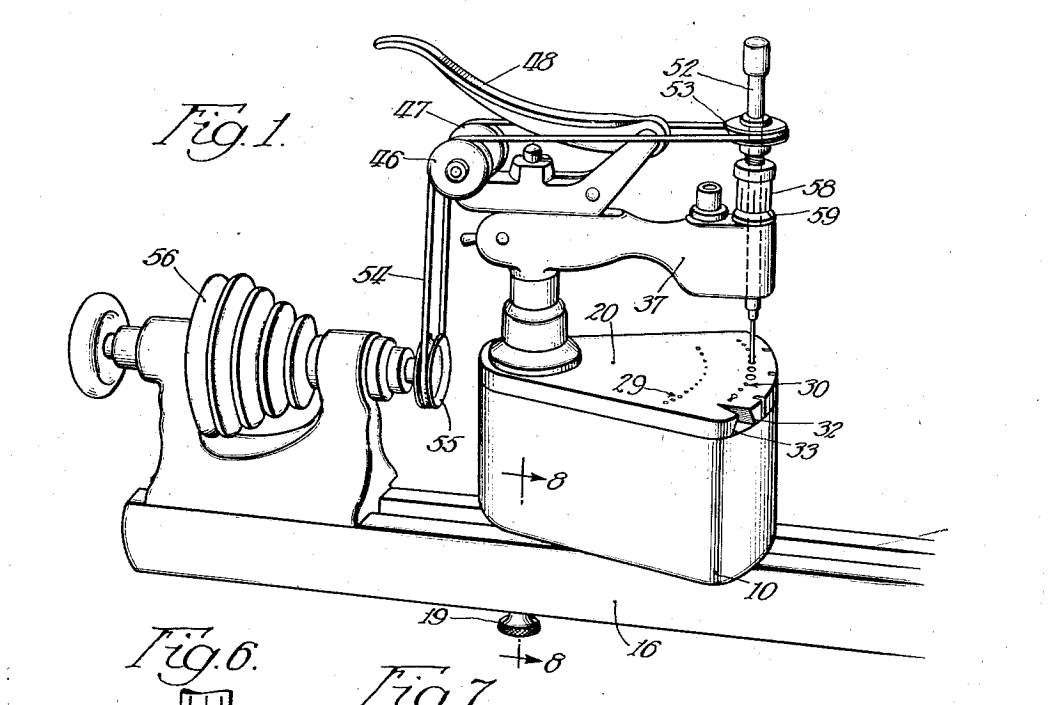

21 minutes ago, watchweasol said:
Hi LWS   thats one nifty set up   was it one of your Dads.
Yes it was. I do not recall him setting it up on the lathe though.  He had four staking sets and this was one of them.  I set it up on one of my lathes to try it out and it works, but I have never used it on an actual project.
I made a post about it with pictures here.
Edited by LittleWatchShop

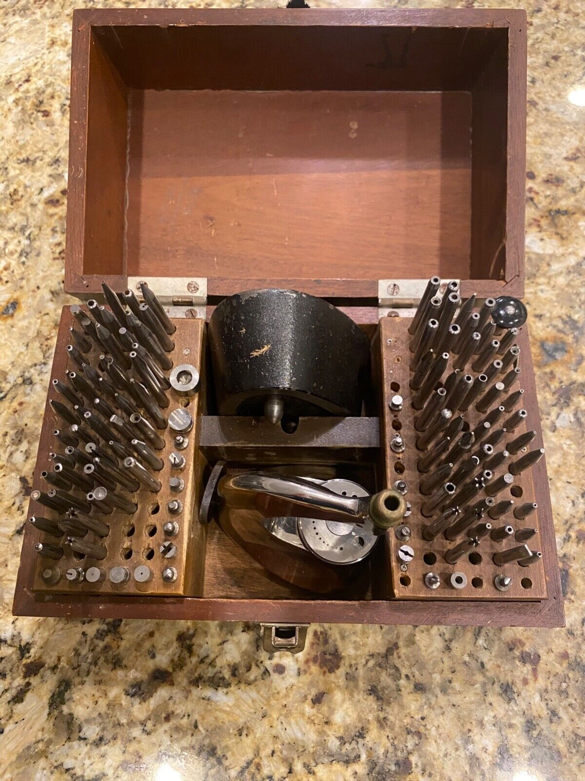

Hey boyos. This is 100 bucks on the bay right now. I saw love for g-boley staking sets in the thread but they usually had numbers and i don't see a number for this one. I'm legit not even sure what you do with a staking set as i'm only doing basic services but i am almost certainly going to horology school at this point and i know it's something i'll need. Vintage Boley from a watchmakers estate. There's stakes missing but i'm assuming you can fill in the gaps as you need to. You guys think should i go for it? It looks in good condition and also like something you could probably club a rock to death with and it would still work fine.
Edited by Birbdad
Thats a nice set with the base to reverse the stakes. If its a buy it now then grab it quick. If its up for bids then likely it will 3 x that.
Yikes given the fact i will need a staking set eventually what should my ceiling be on it you think 300 or so?  It is sadly not a buy it now.
EDIT: Bid 200 on it. I see staking sets coming up in random watch repair vids usually involving balance staffs. I should probably start watching vids on them.
Edited by Birbdad
4 minutes ago, Birbdad said:
Yikes given the fact i will need a staking set eventually what should my ceiling be on it you think?
Affraid I'm  no expert on staking sets or their value. I have a Star that was mostly complete that came in at a good price of around £80. But i was very very lucky and here in the UK the price is usually higher than USA.The Boley I'm sure is much better quality than mine. If i  personally was looking again and saw a complete set in good condition, i would be wanting to stop at around £300 but I'm also tight.
Well if i get it and it sucks i'm holding you personally responsible haha
So what do you typically use your staking set for?
Edited by Birbdad
I got a Chinese set for about $100 and have used it a few times and very happy - so if you don't get the one on eBay this may be an option for you - check out thread Quality Chinese Tools on this forum
Haha. As far as i know the Boley is a good make but maybe not the best. If i was serious about a career in watch repair i would want the best i could get and in a complete condition.  Plenty here that can advice you much better than i can what to buy . Earlier this week i could kick myself for holding back on price with a very complete production lathe. It went for 50 more than my top bid yet i originally planned to go higher than it sold for 😢.  For starters the staking set will replace you a broken balance staff which is a common issue. I dont think there is anything else that can install one.
