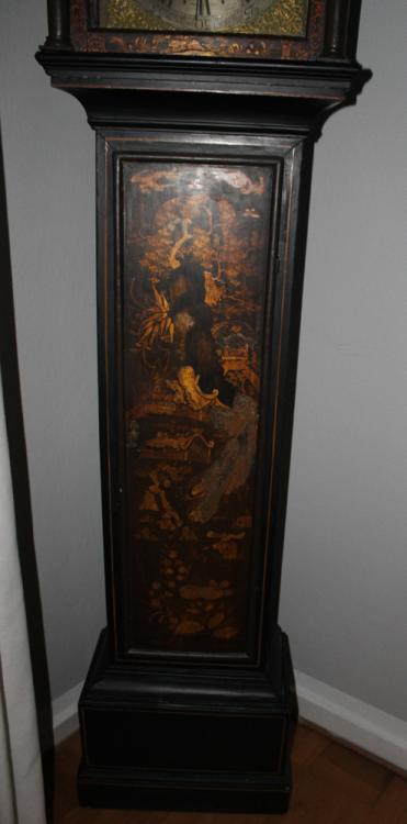

I received a long case clock, weight driving pendulum with a strike & time-train. it has a date- & Moon-complication and has two sub-dials; one for the seconds and the other for the moon-position/day.
It is said to be a Danish "Bornholmer" clock; I have so my doubts but it may well be !? Is there anybody who can identify this clock, can put a date era on it, has some information about it? Is it indeed a Danish or more a British design?
Here are some pictures, the first are taking by the owner and aren't the best of quality;

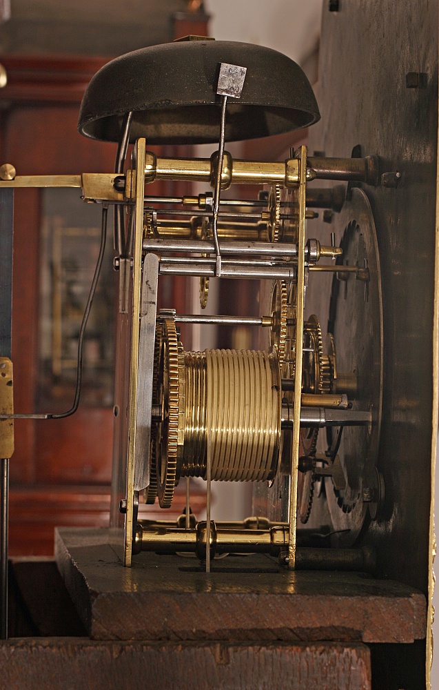

I taped-off the winding barrels, so the gut-wire wouldn't be all over the place when the weights came off;

@StuartBaker104: I had a good look at the dial and the movement. Nothing conclusive here, but the dial pillars match up perfectly with the only 4x holes in the movement plate. Also the hand-made screws holding the dial ornaments to the copper plate are identical to the screws holding the escape wheel bracket. Again, that isn't conclusive, it may have been a watchmaker who had a whole box full of these screws, but at the moment I don't notice anything which makes me go "Hmmm ........." .
That's indeed a great picture of the movement and it looks almost identical to the movement on hand. Also the movement / dial combination seems to be the same. Striking works seem different, but the movements are in the same "style".
Movement of the clock for sale;
Clock at hand;
Even the wooden bottom plate seems original, even though the mounting (system) has changed. However the wood has still the two original holes underneath the movement pillars; the way it was originally mounted as seen on the picture "clock for sale".
