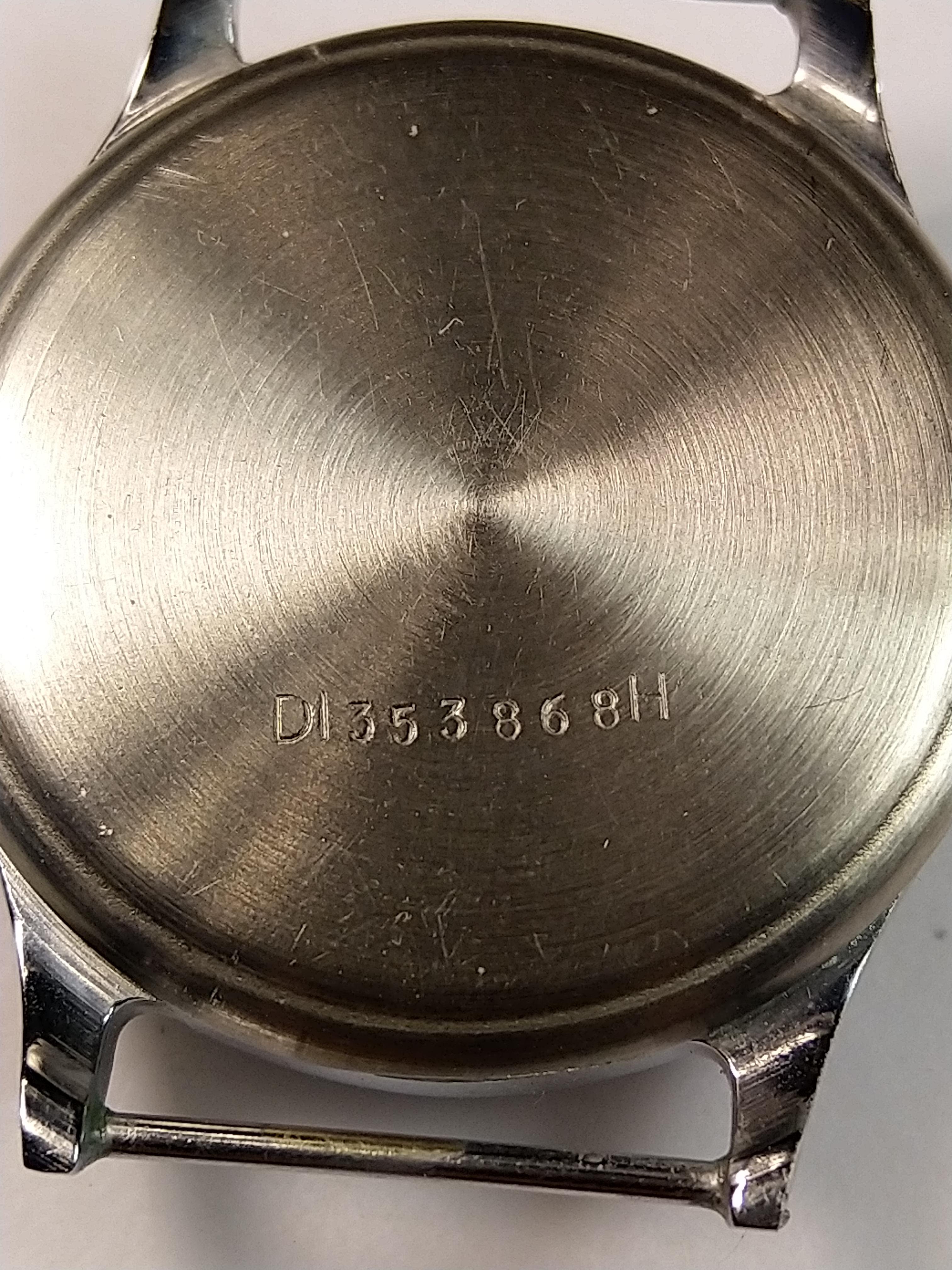

On 9/1/2019 at 9:19 AM, HSL said:
Just as a fun fact in the same theme, there was a bunch of cases roaming around for a while. I'm sure they are contemorary WW2 stuff but probably never used. I've seen these NOS cases with Helvetia 800C movements in them.
I guess they seem to be more accepted these days but is it a genuine WW2 watch? Can one just pop in a movement in them and say they just made a restauration, after all the cases doesn't meet any specs setup as a military watch. Maybe they needed a coctail watch for nicer receptions?
I also have a page on Helvetia DIH watches and these NOS cases:
https://www.helvetiahistory.co.uk/german-military-dih-watches
Thanks. Carl.
