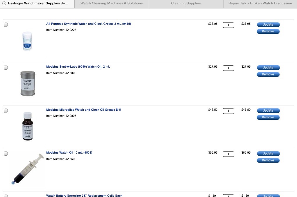

About to purchase the suggested lubricants and wanted to know if these prices seem normal to you? It's nearly $200 for just 4 small lubes! Anyone seen them anywhere cheaper/smaller quantity? This is my cart on esslinger.com
I actually talked my local watch shop into selling me small amounts of the oils. They said since I am a good customer they wouldn't mind me bringing my oil cups down for a small fee of $15! I guess it pays to be a loyal customer sometimes.
