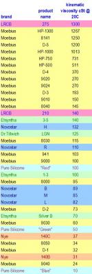

@Rob : Thank you for this great chart. Printed and stored in my tool case :)

Do people actually use these motor oil and other alternatives?
Not really. In professional watchmakers no place for experiments. There are standards which lead to accurate results.
However in the present essay are shown, REFERENCE ONLY, the properties of automotive lubricants.
Lubricants have certain properties that make them suitable for conditions such as temperature, work requirements, etc.
Knowing the properties of lubricants, particularly its viscosity is measured in cSt. (Centistokes) allows us to better understand the art of lubricating watches.
On a personal level I have experimented with synthetic lubricant automotive in Swiss watches. But watches are my property that I use for testing.
When it comes to work, I use recognized as Moebius 8000, in the most critical parts of the Swiss watch lubricants. For example the mechanism of escape: Escape wheel, anchor pallets, pivots balance staff.
Here a link performance of a clock lubricated with synthetic oil vehicle.
GuidoV.
