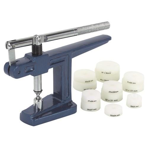

Im also looking to get a new crystal press. I came across these two on cousins. Are they any good and worth it? I do not have a very high budget to get the bergeon or horotec just yet.
Any experiences with these? I was initially thinking to get bergeon high copy from Alix but read mixed comments here on chinese reps so now im confused
I was thinking if i can get aliX bergeon copy and add a swiss vice and dies?
Both these two can be had on AliX or Ebay for a fraction of the Cousins price.  As mentioned earlier in this topic (please take the time to read it) I do not recommend the first one as the press is not lined with the pillars it will distort with a a minimum of force.
Yes i did read it and my apologies for not keeping that in mind. I was thinking from cousins it would be much better quality.
Have you had experience using the second one? Is it worth it and works fine? If dies are an issue i could buy swiss dies no?

No, they are the same identical Chinese items with a quite unreasonable markup.

Some say a screw type is better because gives fine control. Some like the feeling of a lever type. Dies are all the same within their type of threaded or bored hole. As with any tool the real difference is made by how it's used.

Why not starting with economy tool and then grow as the real necessity dictates. For example, less than $20 for a lever type.
hand operated https://www.aliexpress.com/item/4000001532524.html
some bench types, that you can screw on your own board https://www.aliexpress.com/item/4001088371677.html
A large set of additional dies is very affordable also.

From what I have heard those cheap types do not line up correctly and you are more likely to break the glass and damage the watch. Buy the best you can afford, a good one if looked after will last a life time.
I have one of these cheap press ones. I noticed a lot of instability and breakage of crystal so im looking to get an improved one that wont break my bank a lot
Not all the ones that I've linked above are the cheap type, there is a range of prices before getting to the 5500 copy. On the other hand if you have experienced trouble with lever type maybe a screw one would be better.

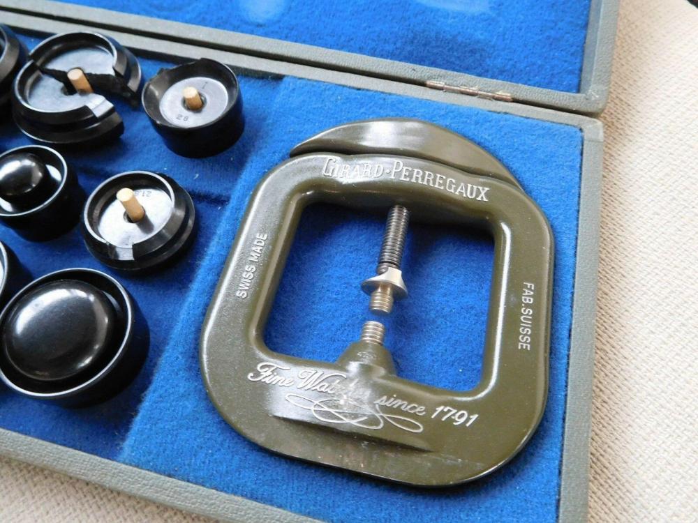

Has anyone tried one of the Girard Perregaux "Presto" hand-held crystal press, or a similar one?  The design looks like it would be resistant to flexing or getting out-of-square, but as I've never even heard anyone discuss this type, and no one seems to make a modern version, I wonder if it's one of those things that just didn't work that well and was consigned to the ash-heap of horological tool history.
Which is very good.
Quote
I think that the cost of cast / forged construction, and not being a name brand or copy of, makes that would not sell good.
