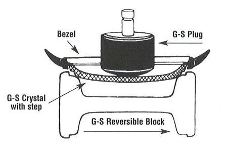

A usage question on crystal replacements: given a pocket watch with a high-dome acrylic crystal, I have read recommendations in various places to use any of the following:
  • properly support the bezel and simply press the crystal in (applying force at the edges) until it pops home, possibly using a concave die to at least help the crystal squish in
  • use a crystal lift (although these, or at least the Bergeon 4266, seem to top out at 45mm so larger pocket watches are problematic)
  • use a press on the crystal only (apply force around the edge vs the center) until it deforms enough for the bezel to fit; see pic below from the GS manual if this isn't clear
#1 seems to be asking for the occasional disaster, #2 doesn't work for large crystals and might scar up the edges a bit, and #3 actually seems fairly safe except for most die sets not including a pusher that looks like that (but maybe just use one's smallest flat die?) and it otherwise doesn't seem to come up much.
Any thoughts?  Are all methods at least tolerably sane, or is there a clear winner depending on other details of the job?  In any discussion on the topic the author mostly seems to bring up only one method without discussing tradeoffs.
PS: since someone well above was talking about having trouble finding large dies: Esslinger sells an add-on die "large die" set that supplements the standard range up to 45mm flat and 57mm concave, look for "Watch Repair Tools Watch Press Large Nylon Die Set of 8".  US$17 or so.
Thank you all for any insight!  This is already a most informative thread.
