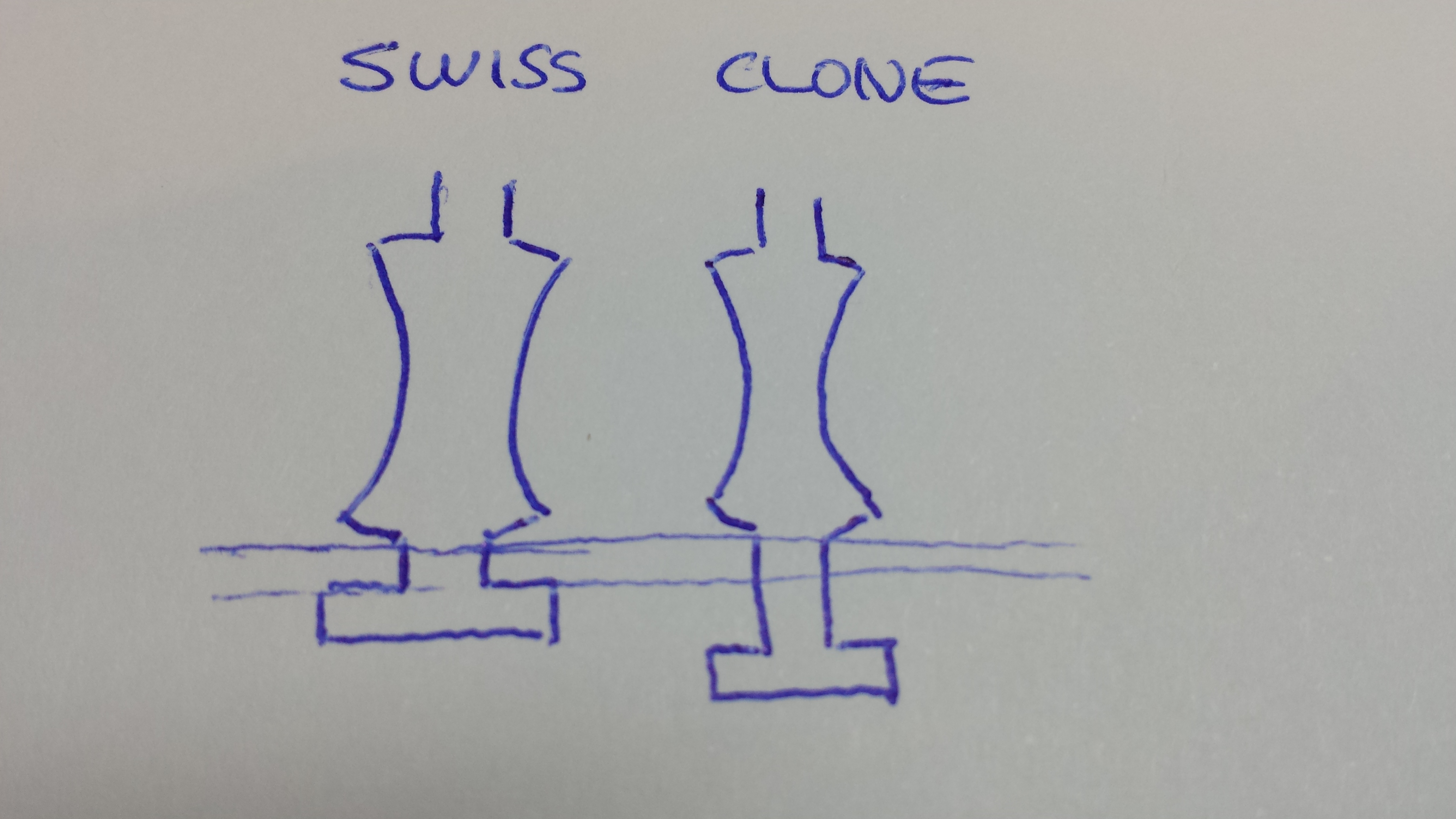

I think Rogart is right. I couldn’t fit it in. I’m not sure whether I’m doing it correctly but I cannot get it in no matter what I do.
I can hold the spring with tweezers, go parallel into the slot and try to turn it 90 degrees to install it. But it only turns say 70-80 degrees and I cannot turn it further.
I would say that the Swiss spring is larger, at least the hinge if not the whole spring.

See attached photo: you could stone the edges of the spring hinge equally on each sides (count the number of strokes). It would need to be very gradual so that it only just fits when pushed into the incabloc setting.
Alternatively, just a get another Chinese movement, but it seems a bit of a waste of money, especially because the replacement spring will also be an excessively loose fit due to their design.

There are three possibilities why it doesn’t fit, I think I’ll only be able to do it if it is the option ‘1’ as per my picture.
I managed to file the hinge, put it in the slot, turned it 90 degrees and it wouldn’t go down. Stands upright, looks perfect but will not move/close.

If I exaggerate, I think this is where the difference is:
Well, you can be glad that you’ve already attempted some relatively advanced watch repair. I’ve seen some experienced watchmakers struggle with these incabloc settings. Keep an eye out for Chinese spares.

Here's the solution I used, though not a perfect one it did the job. I used the standard Incabloc spring made for the LOWER setting. It fits because it has the correctly shaped longer neck.
To install it I held it in a flat nose tweezers at an angle to the slot, lowered the spring into the slot, then turned the movement to align the spring with the slot and carefully lowered it down . Then used a pegwood to push it forward all the way towards the jewel. Then using the pegwood to prevent the spring from sliding back I engaged the ends, one at a time. Then again using pegwood (or a small screwdriver?) I made sure the spring is pushed all the way forward.
