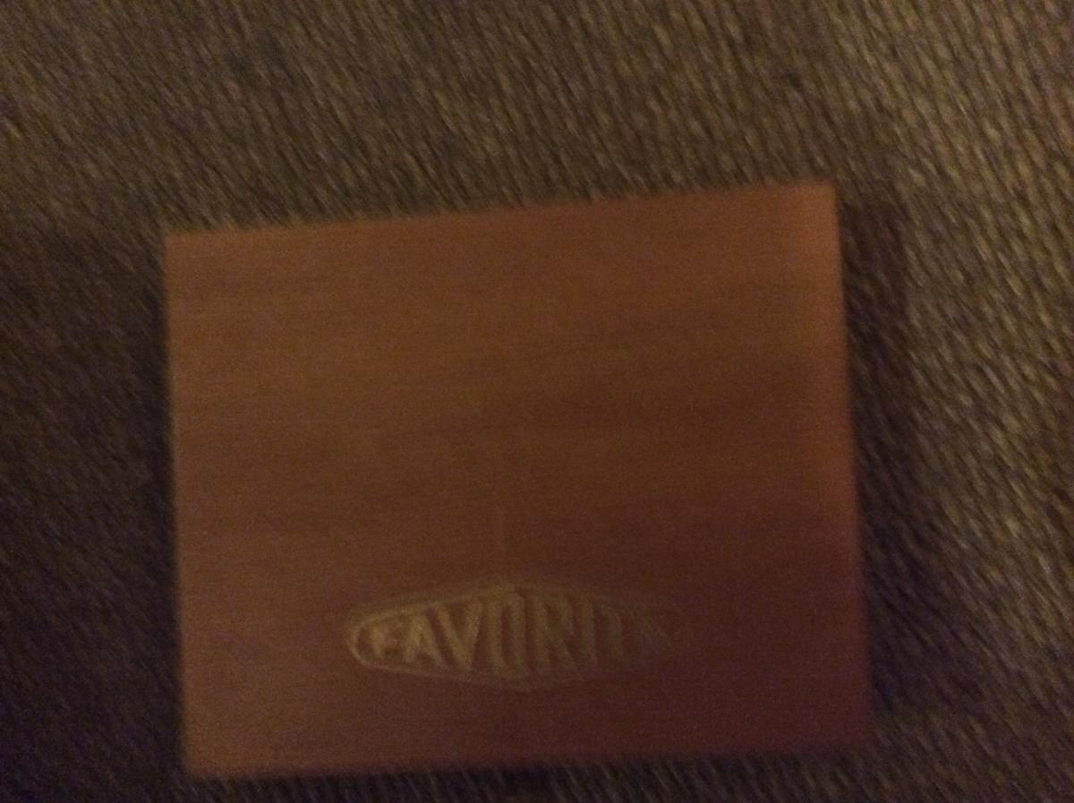

l have bought a "favorite" box of screwdrivers
the screwdrivers inside do not show any branding
the main mark is "BREVET +"
How would one confirm the quality of the favorite brand

Hi Roamerofold,
Looks like they're French, '' Brevet '' means licence in French & '' mod dep ''  ( modele depose ) means ''registered design'' or ''registered trade mark'', quality probably ok !  ,  hope this helps.
Phil.

I had pretty well researched that
but the question is would these be genuine FAVORITE

I occasionally see these Favorite screwdriver sets on sale here in CH. They are offered as 'professional quality' are all original and sell for a good price. Yours looks just the same with the French Swiss marks.
brevet +?
Does the + symbolise Swiss
Does it really matter whether or not they are genuine Favourite.

When a watchmaker friend sold up he let me have a Bergeon set and as far as I can tell, apart from the knob being a little smoother, there isn't a lot of difference. You need to be using them all day on a professional basis to really say you can distinguish differences.
Another point is that I think the really important thing is the quality of the blades. If the ones you have turn out to have faults then just buy new blades and if you want supposed really top quality then buy Bergeon ones but I'm sure it will be a long time before you can tell the difference.
It's a known fact that we all get carried away with acquiring tools and we strive for the best but it"s been pointed out many times that "the best" i.e. Bergeon are ripping us of to a ridiculous extent.
You have a box marked " Favourite " who's going to fake that ?  Accept them for what they are. Use them to repair some watches and be happy. Stop worrying about brand names, it doesn't matter.
What does matter is how well you repair watches.
