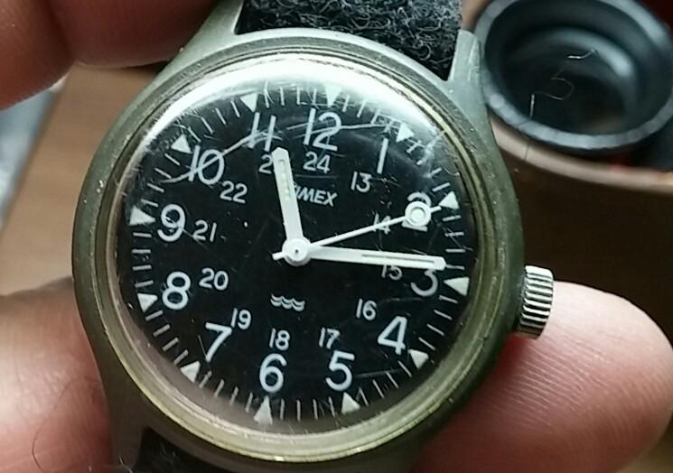

I have been focusing on the Timex Campers the last few weeks and came across that looked like it spent time under ground.
Here is the high level tasks performed:
  • Soak strap in Oxy-Clean
  • Clean case
  • Clean and buff crystal
  • Service movement
  • replace crown
  • grease stem tube
Before and after -
  • Like 7
The total process spans maybe 2 - 3 days which includes the actual break down, restoring and putting it all back together.  This is maybe a total of 45 - 60 minutes.  Why I say 2 - 3 days is to include the overnight soaking of the band and the observation the time keeping, plus any final adjustments.   I've noticed the crown is a bit off center and will have a look if the stem is slightly bent or if the replacement crown itself is the issue.

Very nice!
Have a question for you: that deep black colour on the case, is that just on the surface as anodizing or plating or is that somehow the metal in itself?
If it’s just on the surface I would imagine it would have shown more wear and bright metal shining through?

The case is  a deep green and made of plastic.
Aaahhh... that explains it. For this type of military style watch that makes a lot of sense.
Think I will have to do some ebay hunting for myself here. Is the Timex movement reasonably serviceable on this model?
Haven’t worked on any Timex and hear they can be ”difficult”.

The movement in the Camper is a # 116 which was assembled in Twain.  It can certainly be serviced much to the contrary that many state.  There is no typical need for a full tear down.  Just follow the Timex manual and you'll be fine.  Or you can find an excellent alternate method described on wikibooks under budget watch collecting.  The movement show is a #22 but the same can be done with all mechanical Timex. of the 1950's - 1990's
https://en.wikibooks.org/wiki/Budget_Watch_Collecting/Timex_movement_clean_and_lube
