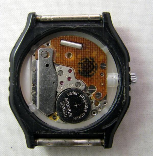

Careful examination of the stub of "gold" to the left might give some clues. It looks as though there was a metal tab attached to that, and floating on that plastic washer, but that may now be missing.
If you had another mech to compare, obviously that would be a help.
Maybe try a small copper wire screwed to that left hand screw and placed on top of the plastic washer, then refit the battery and see if it springs to life.
@AndyHull; seems like a very sensible advice you have given ! Quartz isn't my "specialty", but what you suggest makes sense and seems a very good start :thumbsu:

Also take a look at this pic. of a similar mechanism.
I suspect that Timpsons are fitting the battery incorrectly.
The left hand screw/gold plate, needs careful cleaning, and the right hand tab needs fitting *UNDER* the battery, but above the plastic washer, and insulated in such a way that it doesn't short out the cell at the edge, so perhaps it just needs bent correctly to be recessed in at the right hand side of the battery holder to avoid contact with the edge of the battery. In other words the +ve of the battery looks to be connected to the left hand contact, and the -ve appears to be connected to the right hand contact (avoiding shorting things out in the process). The cell is an SR920SW, which are cheap as chips.
One more point. If they fitted a new battery, and shorted it out, then it is probably dead  by now, so test it with your multimeter, and if it is weak, replace it.
Thanks Andy [emoji106]

Hi Andy thanks for the advice I’ll give it a go when I get a min and report back.
Thanks Kaz
Hi all an update, after completely stripping the movement it was completely covered in battery gunk so put the parts in the cleaner and new battery and all is well :thumbsu:
