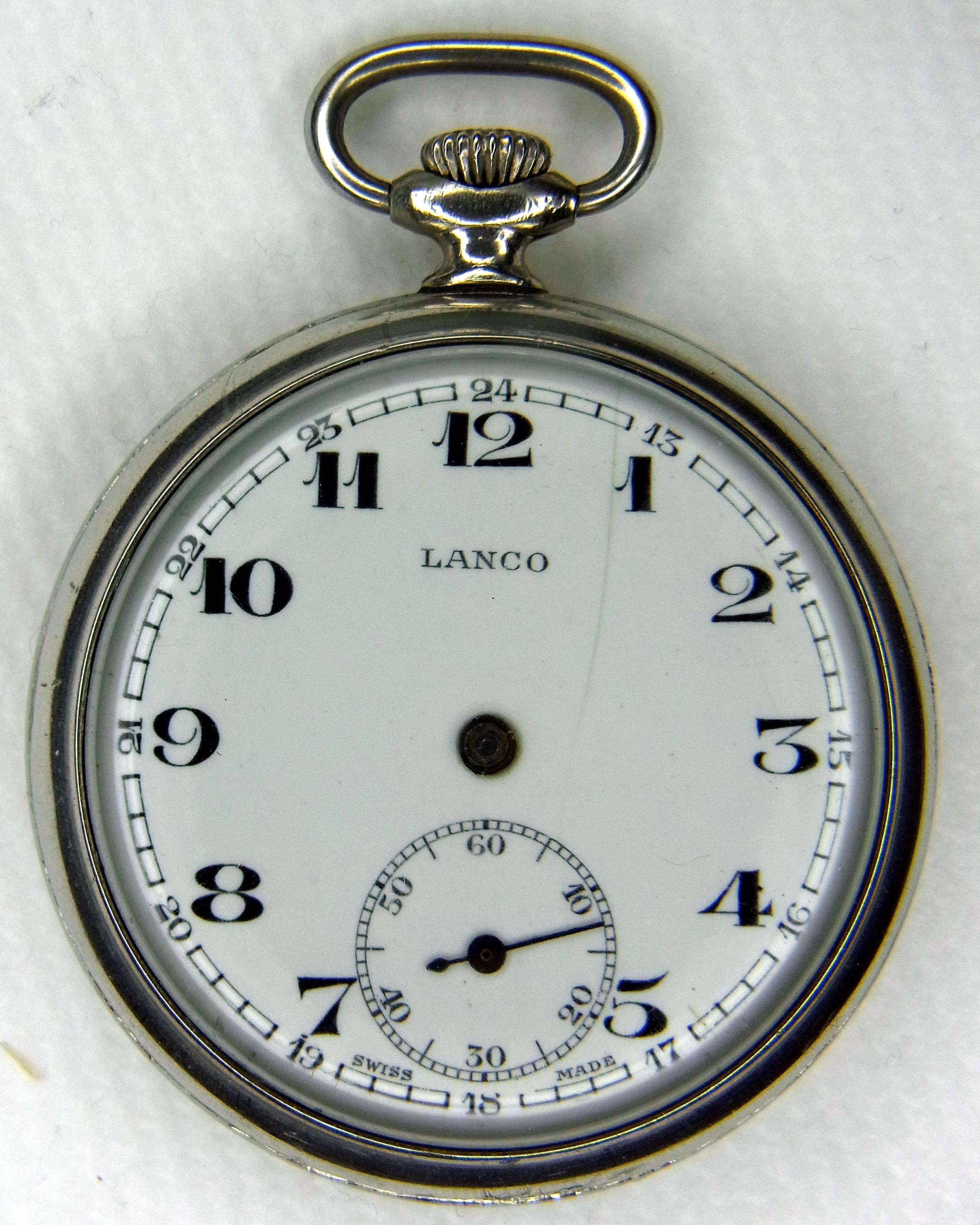

The Lanco - Langendorf 25 (aka 1725) arrived in the post this morning. I would guess this is from the 1920s or 1930s.
I gave it a quick once over to see how much pocket watch you get for £2.20 (+p&p) and was pleasantly surprised.
After a partial strip and clean I have proved it will actually go. The palette clicks over nicely in response to a slight nudge, but there are a few hurdles to jump before it is fully functional.
It needs an hour and minute hand (Ranfft states these are "Hands 2.05 x 1.20/0.25 mm" ) - which I suspect are the easy part, and it needs a few balance parts. To be exact the hairspring, roller table and jewel, balance pivot and the regulator arm.
Alternatively, if there is a source of a complete balance, then the thing will be fully working once more.
