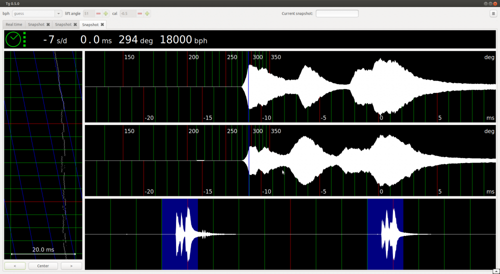

I'm not sure how exciting a bunch of time grapher results are, but for the record, here are this mornings readings.
Dial up and dial down. The positional variation is not too bad in the other positions.
From around -8 to +10 or so (possibly a little less if I actually give it a bit more time to settle).
The lowest amplitude is the 12 down position 255 degrees. Highest beat error is about 0.6  with 12 o'clock up and +10 s/d.
Not quite COSC, but not bad considering it has probably only been serviced once in its life, and that too by a lunatic with baby oil and saddle shine.
Today's numbers are in (dial up and dial down shown), and things are still looking pretty good.
Over all, it appears to be about 3 seconds fast over the week. Bear in mind this doesn't mean the same as it being invariably accurate to less than a  second per day, as at different times of the day that number will drift up and down. Not by much though admittedly.

A quick update from the "horse lineament" oiling experiment.  First we have dial up before winding.
Next is dial up after winding.
Its a little chilly this morning, and that may have resulted in marginally lower amplitude than it has shown after winding up until now. Previous days have all been around the 278 deg or 280 mark.
I may check it again after it has been on my wrist for a while.
None the less, it seems to be going strong and keeping consistent time.

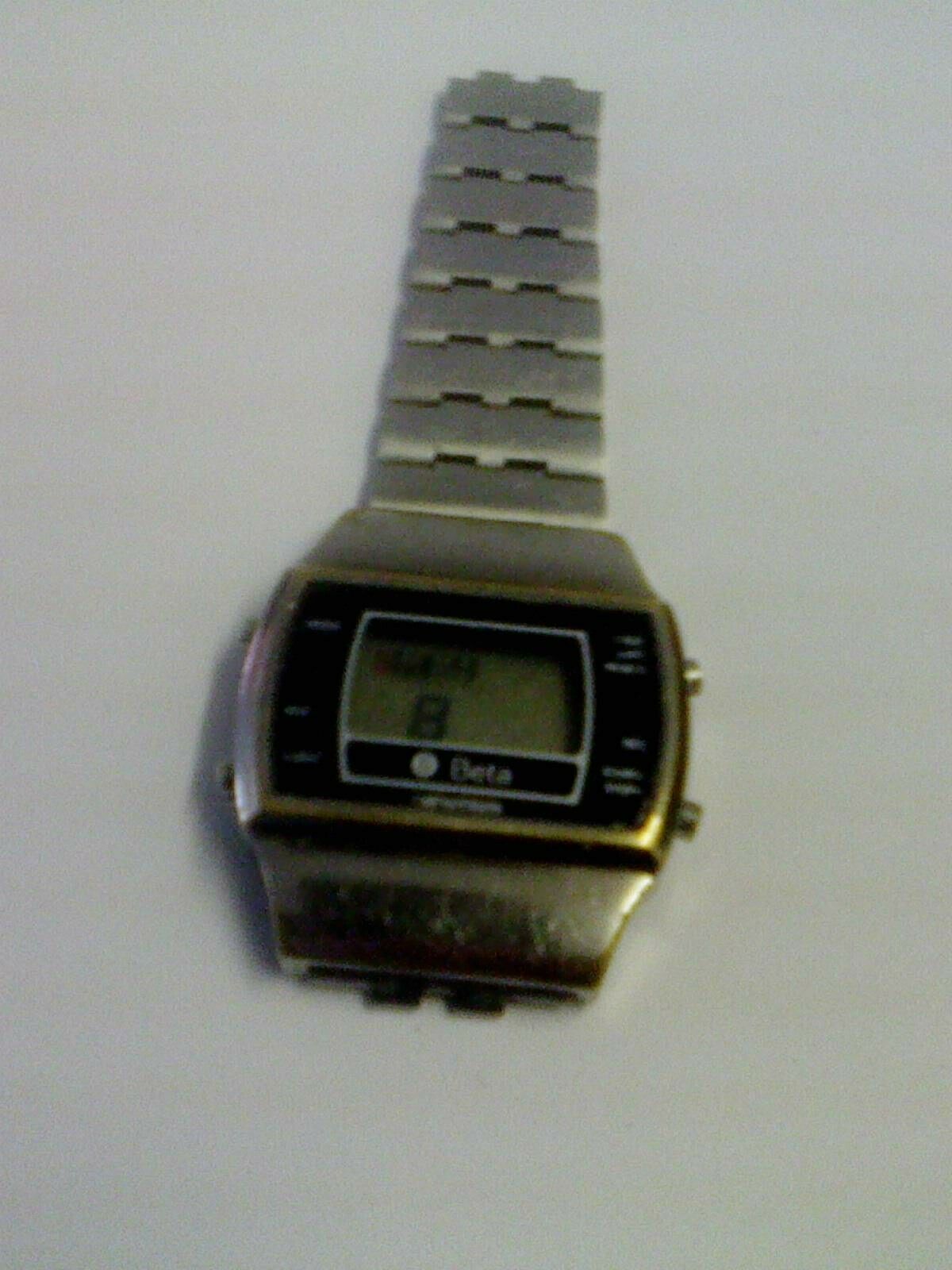

Some pictures of the Beta LCD watch that I posted in the 404 club thread. LCD modules are actually pretty easy to work with if you can use small screwdrivers, magnification and perhaps occasionally solder or conductive paint.
Generally there is not much you can do with faulty LCD modules other than clean everything. They rely on a 'black blob" to do all the clever stuff, and a quartz crystal to keep the time. The blob cannot be replaced, but sometimes the crystal can.
In this particular case, I did do a little light surgery to the board, which had a corner cracked off it. The two pieces were re-united with a tiny drop of cyanoacrylate glue (superglue) and the track that was damaged in the breakage was repaired with conductive silver paint (available from the usual suspects via ebay).
Things to be aware of.
1) The LCD is made of glass and is therefore very easily broken.
2) The connection between the glass and the main circuit board relies on a thin strip of conductive "rubber".
This strip is actually a sandwich of alternating conductive and insulating silicone rubber polymers and is often referred to as a "Zebra strip". This strip can deform and expand, due to ingress of moisture or solvents.
You can, at a pinch, sometimes get away with shortening it by a couple of stripes, if it has swollen to the point where it is too long to fit in its original location.
3) The conductive layer on the glass (indium tin oxide) can be carefully cleaned with lighter fluid or isopropanol, however take care with the solvents you use as they can affect the zebra strip and cause it to puff up. Clean the zebra strip by gently rubbing it with an ink rubber. If you absolutely must use a solvent on the zebra strip, use a very small amount. Lighter fluid is usually safe on the zebra strip, but your mileage may vary.
4) The battery contacts often get covered with leaked battery juice. This is generally alkali, and you can attack this crud with a little bit of white vinegar on a cotton bud. This will neutralise the alkali but should be cleaned off with plain water and perhaps a little dish soap and allowed to dry completely before re-assembly.
There is a slight chance that the crud may contain mercury or cadmium, in which case, wear gloves when dealing with it and avoid breathing in the dust. Generally though, it is likely to have zinc, manganese or silver salts, which are still not a good idea to ingest, but far less of a worry.
Wash your hands afterwards.
5) You can sometimes fabricate replacement battery contacts from copper strip, fine stainless steel wire, or thin brass stock, depending on the application. Note that it is almost impossible to reliably solder to stainless wire with lead free solder.
6) There needs to be even pressure on the zebra strip to ensure that it makes good contact with the glass, but remember it is glass, so if you crank down too hard on things, the glass will simply break and your LCD module will be toast.
7) The front of the display contains a polarizing filter and the rear generally has a reflector, if you forget to fit either of these, then the display will not work.
8 ) Contact between the pushers and the module selects the various functions, so the case of the watch is often used as one of the parts of the circuit. Current flows from the battery through the case, then through the pusher to the contact on the side of the module. If any of this path is broken or dirty, then the buttons wont work, so make sure everything is shiny and clean, and that any contact spring between the watch module and the case is fitted, and makes good contact.
9) In older modules like this, the back light is a filament "grain of wheat" bulb rather than an LED, and when the battery starts to get a little weak, pressing the button for the light can sometimes crash the module, simply because the bulb draws too much current, and causes the voltage in the cell to drop, and thus the controller circuit to "brown out" and crash.
Here is a before and after shot. The before is from the ebay listing.
.. and here it is after a little TLC
There isn't much to put you off having a crack at repairing LCD watches. They are small certainly, but they are relatively simple to deal with if you follow the basics and clean and inspect everything carefully. Furthermore, this one only cost one penny at auction, so you can pick up a few bargain basement ones to practice with very easily.
