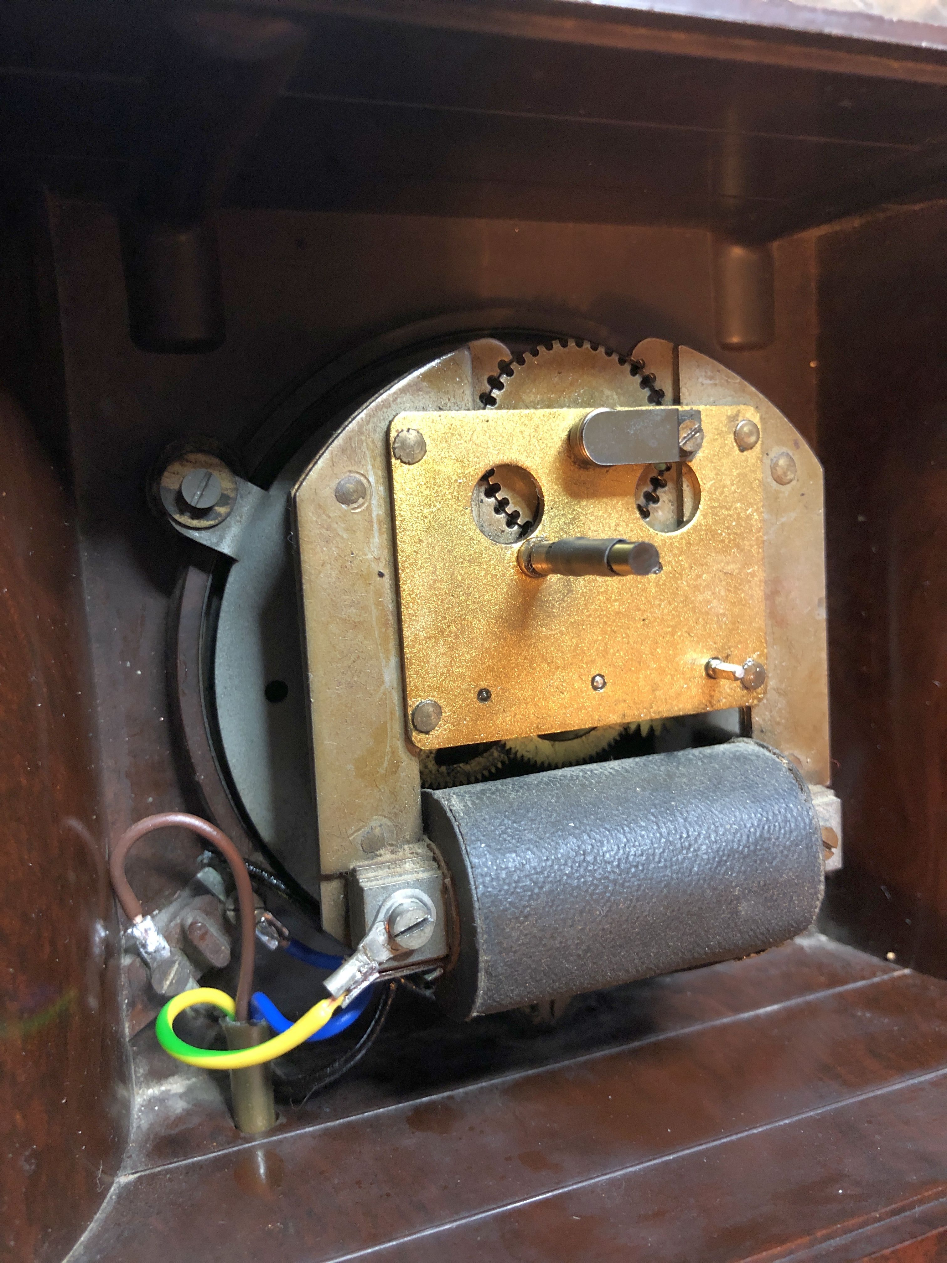

Typical movement for the non alarm varieties (in the No4 Model)......

Very nice. Notice that the mechanism looks very similar to the design of the Metamec, including an almost identical low friction bushing on the rotor.
The coil is even larger, presumably using slightly coarser gauge wire, and is therefore probably even less efficient. The motor in these probably consumes something of the order of 2 to 10 watts, most of which is lost as heat. While this is not a hug amount in the grand scheme of things, it is many orders of magnitude greater than a quartz mechanism or even a transistorised coil oscillator one.
Because the coils run warm, and because the coils consist of many turns of fine wire effectively strapped directly across the mains, the coil is by far and away the most stressed component, and presumably the one most likely to fail. Failure to keep the mechanism clean and lubricated, or leaving the motor in a stalled condition will also lead to stress on the coil.
One thing yours has, which the Metamec does not, is an earth, which is a very nice safety feature. If that coil ever starts to break down and allows the electricity to track to the metal work things could get very interesting with out the earth.
Hopefully the double insulation of the Metamec coil will prevent any such problem, but I am still a little wary of the potential for a nasty surprise when adjusting the hands. Hopefully too, I never get to test this theory, or if I do, the RCD in the consumer unit kicks in before my hair stands on end.

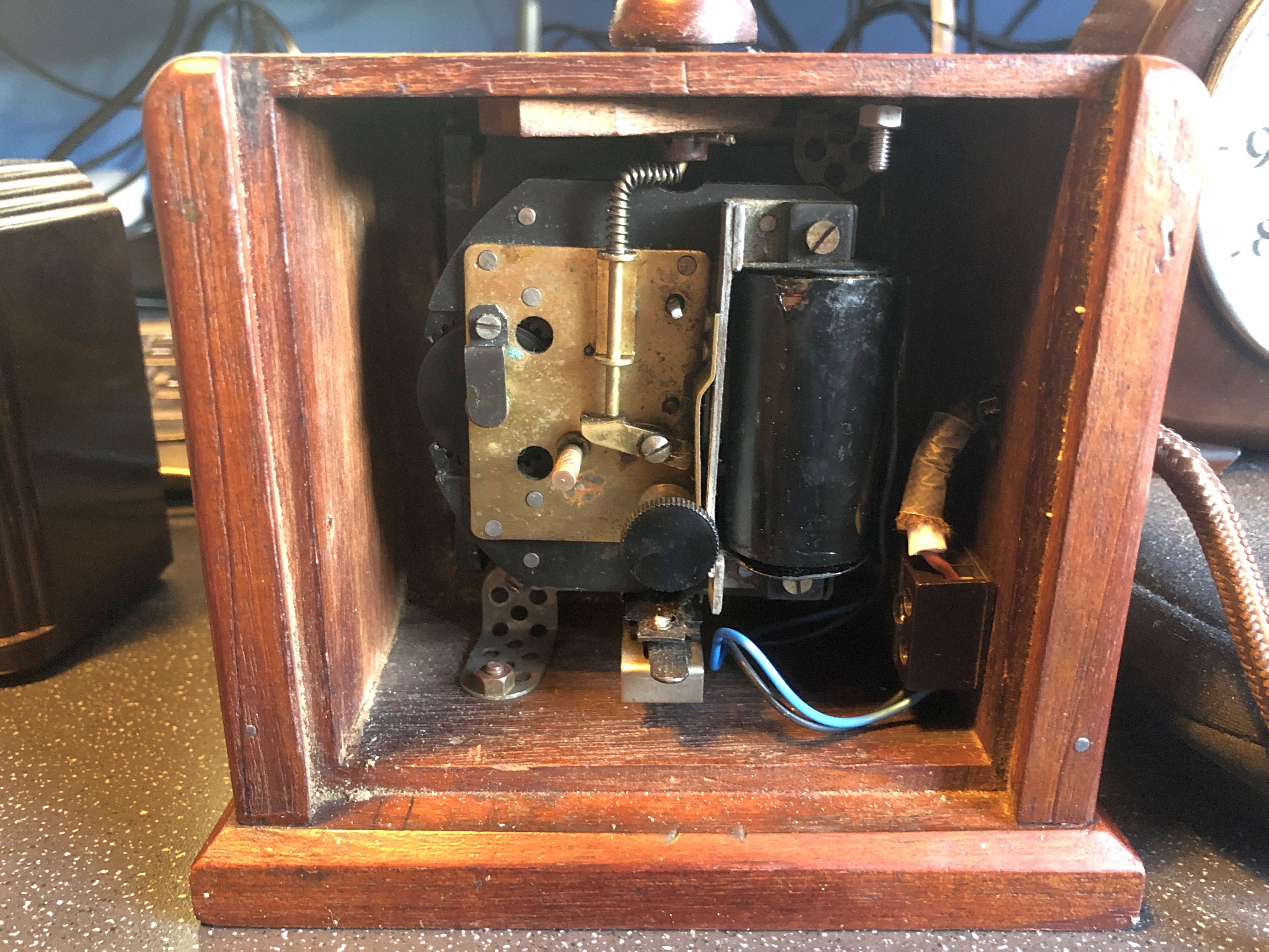

This is the mechanism in the 'Floodlight alarm' identical to the other alarm that I have other than a simple cam mech to turn the dial light on at midnight and off at 8am, which sadly doesn't work as the secondary winding in the coil that turns it into a 3volt transformer, is open circuit...☹️.
2131015632_HomemadecaseFerrantialarmwithlight7.thumb.jpg.d16b5603610399594e488d4d3c2881b9.jpg
Note the use of Meccano to hold the movement in the case ?

You could easily hide a small LED driver in the case. They are tiny, and would not look out of place in this Heath Robinson contraption. You could even hide it in its own Mechano or wooden box.
https://www.ebay.co.uk/sch/i.html?_from=R40&_trksid=p2334524.m570.l1313&_nkw=led+driver&_sacat=0&LH_TitleDesc=0&_sop=15&_osacat=0&_odkw=3v+transformer
I assume the clock has some switched contacts, so you could use those to switch the low voltage output to drive a suitable  LED bulb.

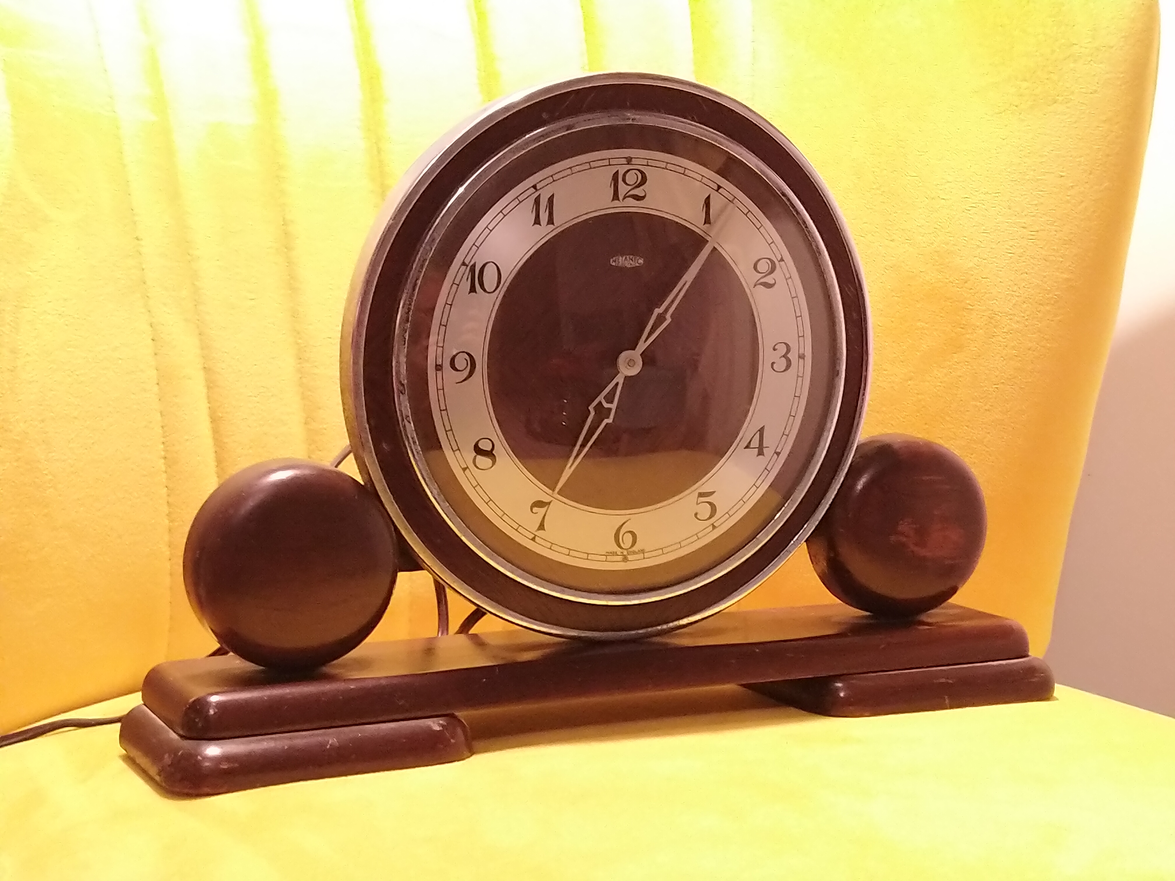

Hi Andy,
I received my book: METAMEC, THE CLOCKMAKER, DEREHAM and I think I found your clock in it. It seems to be the model 779. There was a version with alarm and one without it. The hands do not seem to be the same though. I did not know but the METAMEC stands for 'Metal and Mechanical Products'. The book is fantastic, at least thats what I think. The link above says you can have it for £10 + P&P I paid £15 +P&P. Sorry for the picture quality in the PDF i have not played a lot with our little scanner yet and noticed the horrible result when I finished. The book has better pics and color pics too. I scanned a 3 pages about Automatic Tea Makers. It might give you and idea when you go to eBay again. ?
I've seen a couple of Metamecs with those Lumed hands, and a couple with the hands that mine has. None were exactly the same shape/model though. Does the book indicate what year(s) it is likely to be from?
