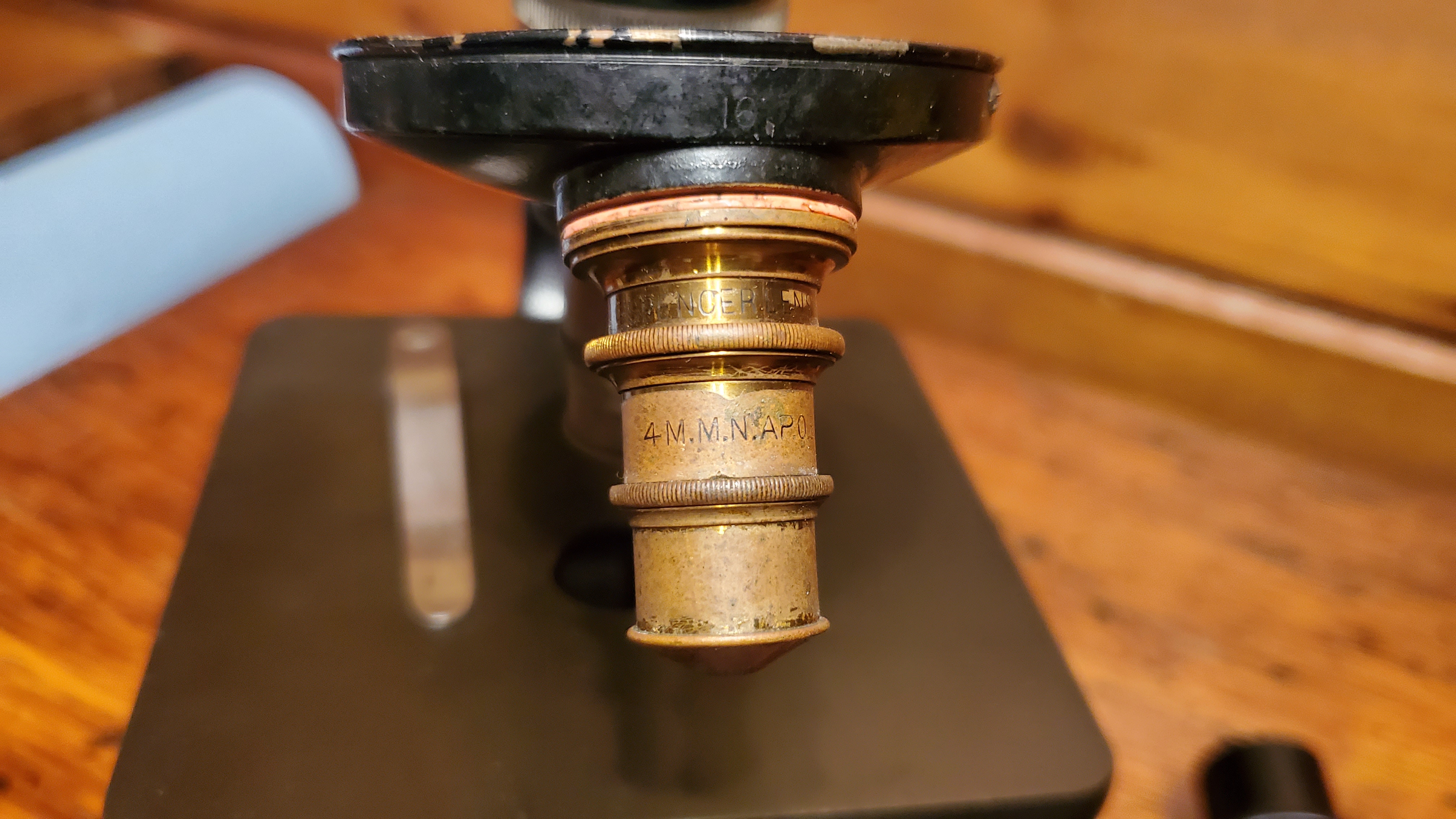

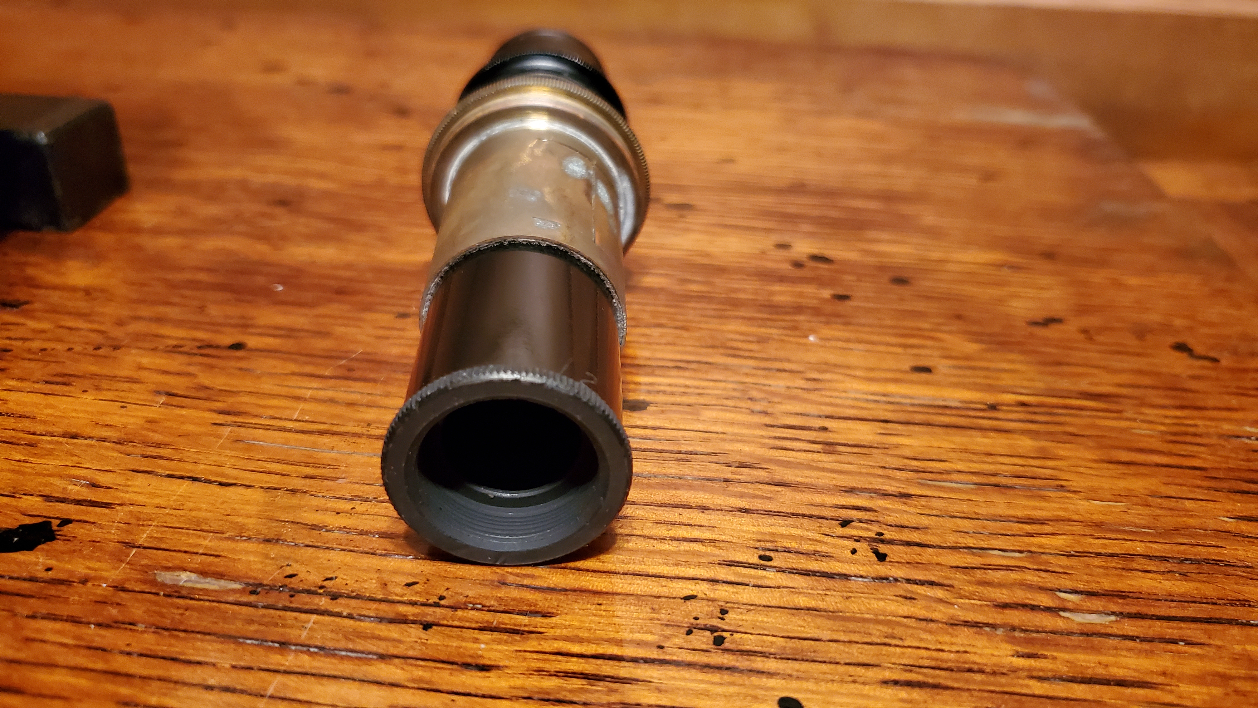

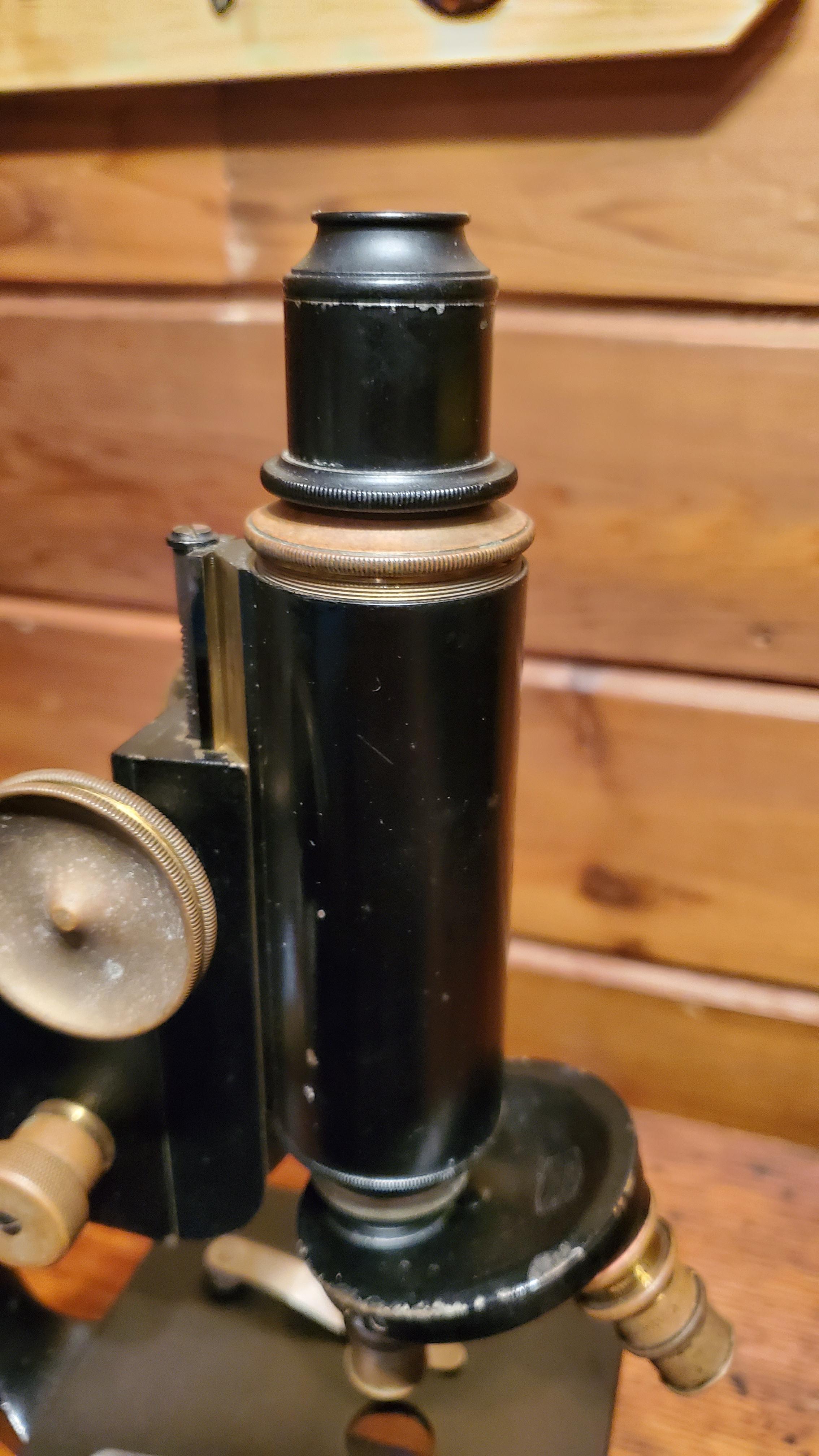

Everything seems to function OK,  but I think there may be a lense component missing as it seems impossible to get this to focus.  I very carefully and thoroughly  cleaned all the optics. In the large, sliding, central tube that the eyepiece sits, I believe there is a lense missing. I'll take a picture later. I did acquire an older (late 1800's) all brass Spencer that had a handful of missing parts.  It was a gift for my eldest son. It's missing the reflector mirror and the eyepiece. He's going to clean it up and get the missing parts.
Perhaps. There is also the possibility that some previous owner has re-assembled the lens elements in the wrong order, or with the wrong spacing.
How many lenses are there, and what do they look like?
Please see attached photos...
Hmmm... I'm not sure about that, you may be correct, but generally these microscopes are pretty rudimentary and consist of a lens at the eyepiece, and a lens or bunch of lenses in the objective.
The critical part is the length of the tube between the lenses. Too long or too short and it will never focus.
Could it be the case that something has altered that length. Maybe some previous owner has jammed something or re-assembled it incorrectly.
Modern microscopes tend to have "standard" tube lengths, but older ones may be pretty much whatever length the manufacturer dreamed up, so over the course of its life, someone may have messed about with the tube to try to "fix" the focus, or they may have tried to use a different objective or eyepiece from the one originally supplied.
This might be worth a read.
https://www.olympus-lifescience.com/en/microscope-resource/primer/anatomy/tubelength/
If you grab a piece of card and cut it to roughly the current length of the tube (start a little too big and trim it down as you experiment), roll it in to a similar tube, and stick the objective in one end with a little piece of insulation tape or whatever, you should be able to mess about with the position of the eye piece relative to the objective and the distance between the objective and the subject to get an idea if the lenses are ever going to focus.

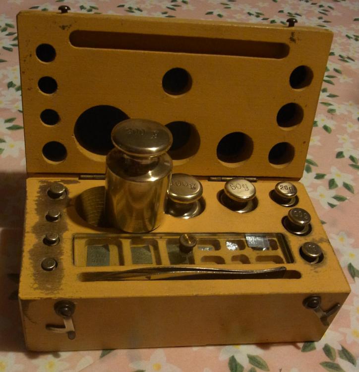

My wife has a fascination for weights and weighing machines, so when this small set of calibrated gram weights showed up on my ebay feed for a couple of quid, I figured it would be just her kind of thing.
I guess the original supplier qualifies them as watch related too.
That is the identical kit we had in the shop I worked in and the same place we got it from. In fact S W C S  were the number 1 in the 70's & 80's . Those little flat pieces are also weights.
