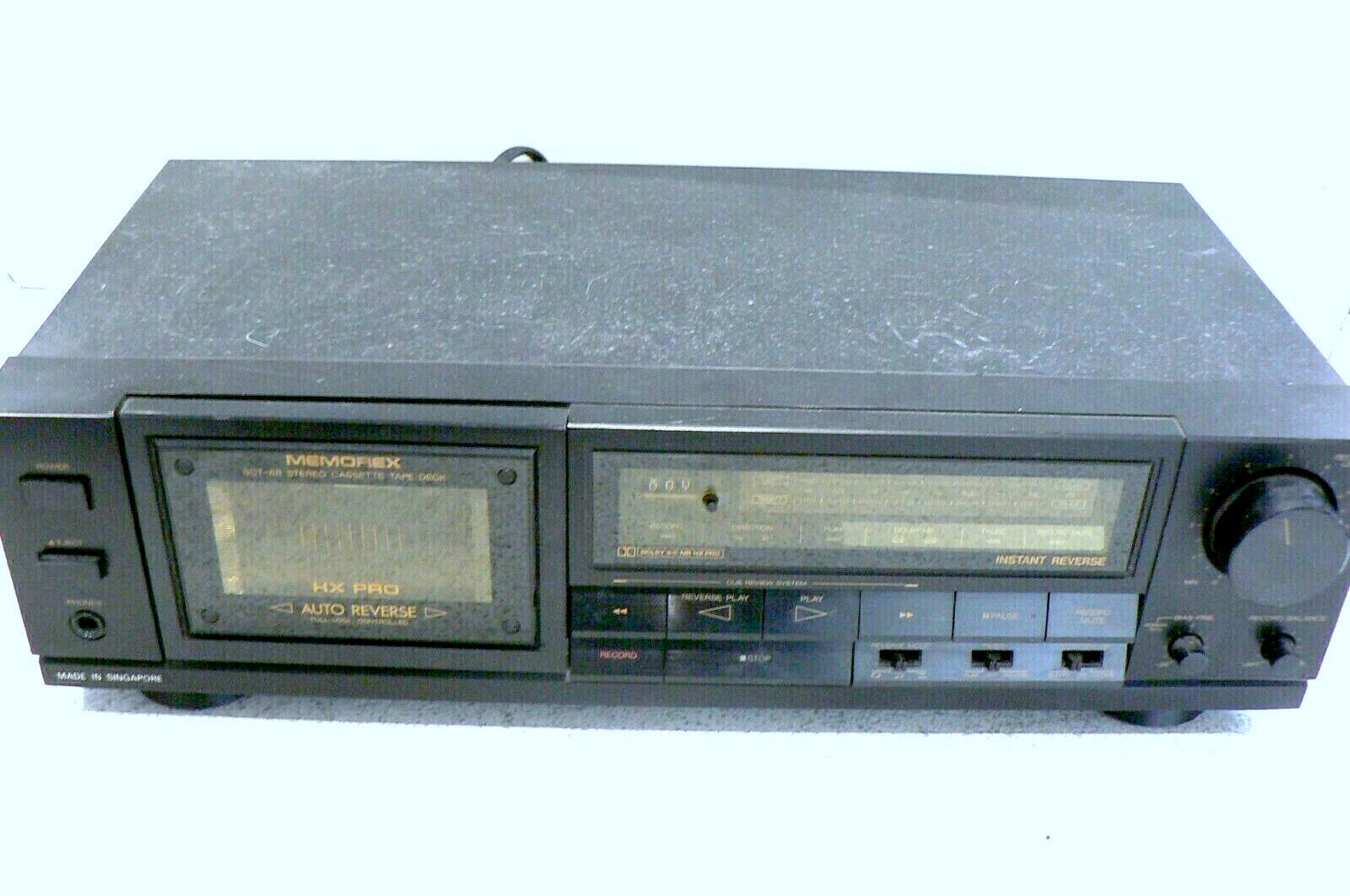

Keeping with the somewhat rambling and completely off topic nature of this thread, I got a spare moment to work on my HiFi project. I started with the rebadged Akai R470 - Memorex SCT-88 tape deck.
This was a bit of a mess when it arrived. Both belts had gone, and the tape counter belt had reverted to a thick black non polymerized goop, which had to be removed before I could even think about fixing any of the other issues.
This is the ebay listing picture for comparison.
It also had a broken clip in the transport mechanism which caused some weird load and eject problems, but that was a relatively easy fix with some supeglue and baking soda. After a fair bit of cleaning and lubricating and some cosmetic work to make it look clean and presentable enough to sit in the living room,  it plays perfectly and looks almost new.
After a little effort, I can now sit and listen to some of the large collection of tapes we still have lying around.
