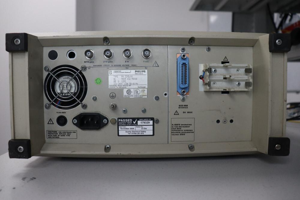

I should really be more careful when I go hunting round ebay. All sorts of junk tends to follow me home.
This time it was a Philips (Fluke) PM3295 350 MHz Oscilloscope.
I don't really need another oscilloscope of course (can you have too many oscilloscopes I wonder), but it only cost... (drumroll) 0.01p (plus shipping).
My current 'scope is Metrix 803B 40MHz which I picked up about 10 years back and repaired, so if I can get this running it will be a bit of an upgrade.
I can almost guarantee that the power supply will need some work (although it does have a safety stamp from 2020), but other than that I have to admit, that even when you factor in twenty quid for shipping,  it does look like the best bargain I've picked up in a long time.
A 350Mhz oscilloscope is obviously overkill for fixing watches, but great for any other electronics projects that come along.
