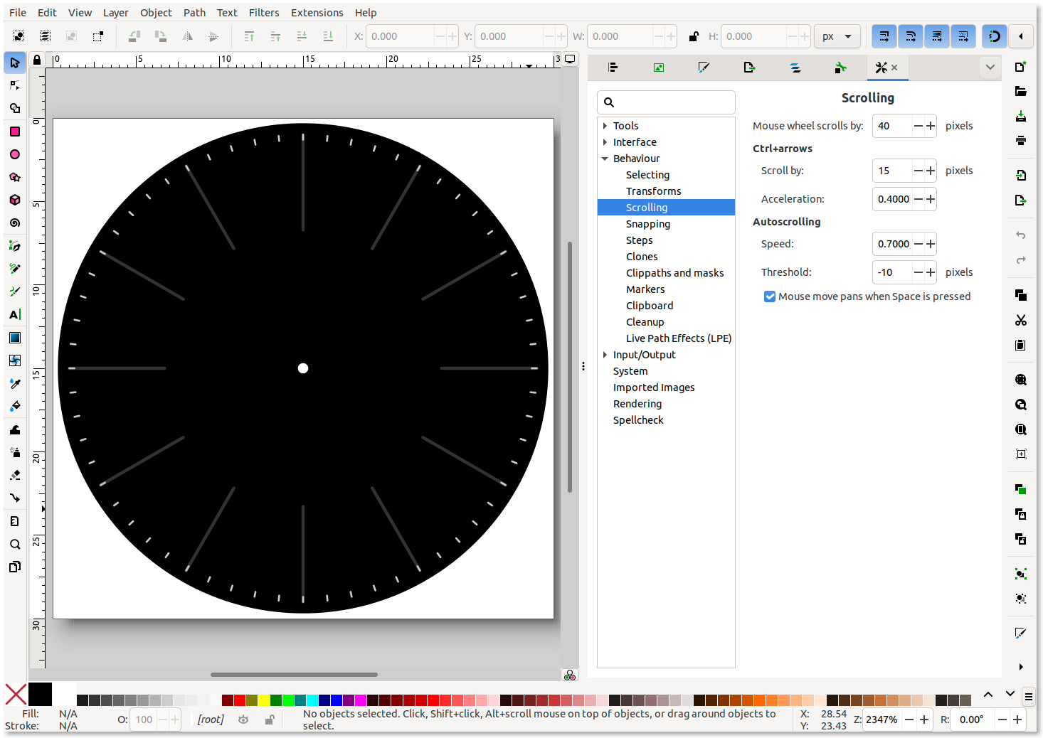

I saved this as 30mmWatchDial.py
Next a ran the code (using python of course).
 python 30mmWatchDial.py >30mmWatchDial.svg
 ... and here is the result displayed in Inkscape.
Here is a png of the .svg
.. and the .svg saved as a .svg.rtf is attached to the bottom of this post.
Save it as .svg and you can open it in Inkscape.

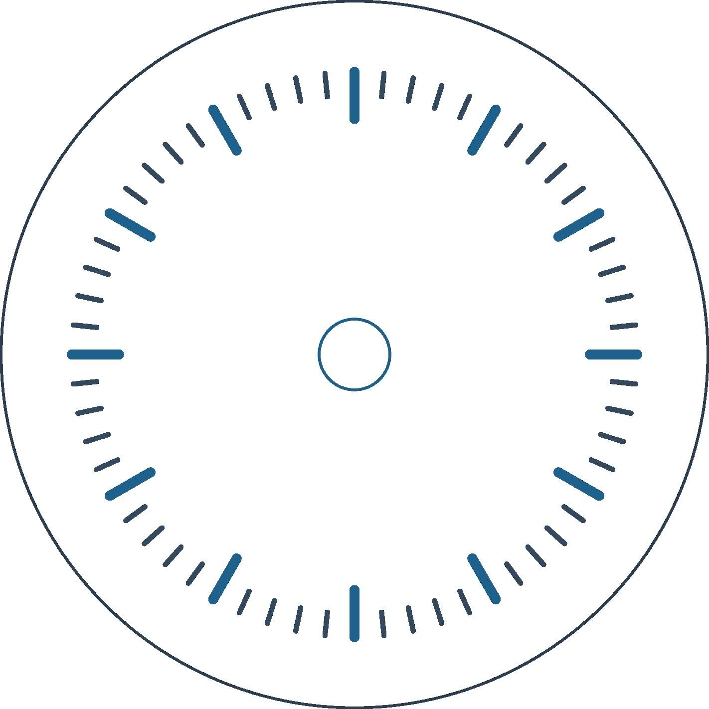

Here is the revised python  .SVG dial generating script.

I'm not going to teach anybody how to install and run python, that is a little bit out of the remit of this thread, but if you have the skills and follow along with the chat, you can see it actually does some pretty neat "thinking", if that is the correct word.
Here is our finished "Bauhaus" dial.
Could you print this on transfer paper? Absolutely, and it would be extremely accurate.
Could you use this to drive a laser engraver? Yes, so long as the laser engraver can work with .svg files, although you could convert to any number of other formats, scaleable or raster, so in short, yes, it will work with a laser engraver, or with a vinyl cutter or whatever. Anything that has the resolution to produce fine detail would work.
Finally, could I have written and debugged a similar script in less time without ChatGPT?
Possibly not on my own, but with a second human "buddy coding", and spotting errors and incorrect assumptions, maybe. I've worked with a lot of very sharp coders over the years and when the pressure is on, things can get done pretty quickly.
As you can see from the chatlog, ChatGPT did need quite a few hints, but then again, its not powered by coffee and pizza so what do you expect? It is however blisteringly fast at re-factoring its own code.
Feel free to use the code or the resultant svg and jpeg files if you want.

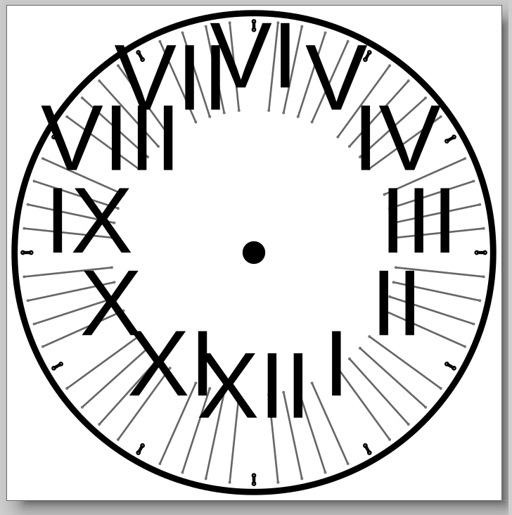

Here is python code to generate this black "bauhaus" dial with grey hour markers and lighter grey minute markers.
One thing that I've noticed is that ChatGPT struggles with the concept of placing text markers as it has difficulty with locating the centre of text objects and/or their bounding boxes. I think this is actually a limitation caused by the python svg library as it appears to lack the necessary object properties/functions to return these dimensions.
This makes placing text markers a more hands on process. "try the X11 (Roman numeral 12) marker a little further down and to the left" that sort of thing.
Since ChatGPT cannot "see" anything, the process of correcting its mistakes is entirely language based. I can't say something like  "can you not see that all of the hour markers are wrong? Sort them!" since it has no real concept of the visual results of its labours.
You can of course edit the resultant .svg file in Inkscape or whatever editor you use, and add your own text in whatever font and location you require.
I must admit this is actually quite a fun learning process, and ChatGPT has boundless patience, unlike some programmers I could name.
It doesn't like to bunk off for a coffee though which is a bit of a down side.
It also cannot see that the code it generated above has a bug, which actually improves the look of the markers. I didn't correct it.
